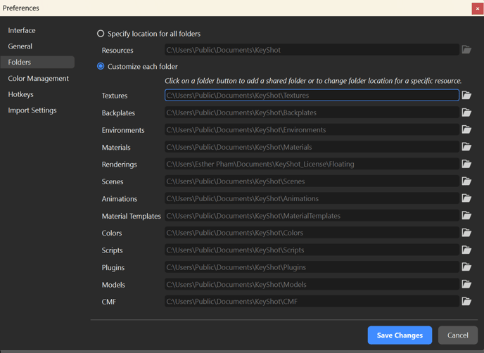

Windows
  1. Launch KeyShot
  2. Go to the Edit drop down menu and select Preferences
  3. Select Folders on the left side panel in the pop-up box that appears
  4. Select Customize each Folder if you would like to specify each folder
  5. Go to Resource you want to add to. Click on the Folder Icon. The Configure Folders window will pop up
  6. Click Add. (plus sign) The Add folder window will pop up
  7. Click the Folder Icon, browse to the desired sub-folder for the relevant resources and click Open
  8. Click Ok twice. Then, click Save Changes
  9. You will now be able to find your sub-folders inside the KeyShot Library window.
Note:
KeyShot sub-folders can be found in:
Users >  User Name > Documents > KeyShot folder. (Installed just for me)
Users > Public > Public Documents > KeyShot folder. (Installed for everyone)

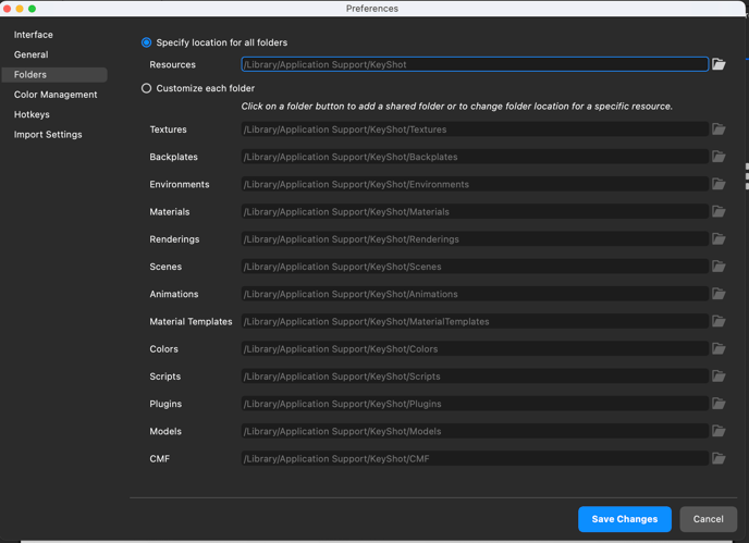

Mac
  1. Launch KeyShot
  2. Go to the KeyShot dropdown menu on the top and select Preferences
  3. In the pop-up window that appears, select Folders in the left side panel
  4. Go to Resource you want to add to. Click on the Folder Icon. The Configure Folders window will pop up
  5. Click Add. (plus sign) The Add folder window will pop up
  6. Click the Folder Icon, browse to the desired sub-folder for the relevant resources and click Open
  7. Click Ok twice. Then, click Save Changes
  8. You will now be able to find your sub-folders inside the KeyShot Library window.
Note: KeyShot sub-folders can be found in Macintosh HD > Library  > Application Support > KeyShot
