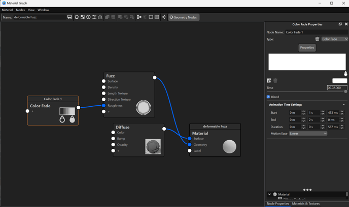

Fuzz on deformable meshes (for versions 2024.1 and prior)
In versions before 2024.2, the geometry nodes do not update on deformable meshes.
In order to mitigate that, a workaround is to add an animation to the material that is plugged into the geometry node, but does nothing (e.g. changes from a HSV value of 0.1 to 0.1). In the example the Roughness is animated but does not change.
Please note: while it will render the animation correctly, it will not automatically update in the real-time view. You will have to manually click the Refresh Geometry Nodes button.

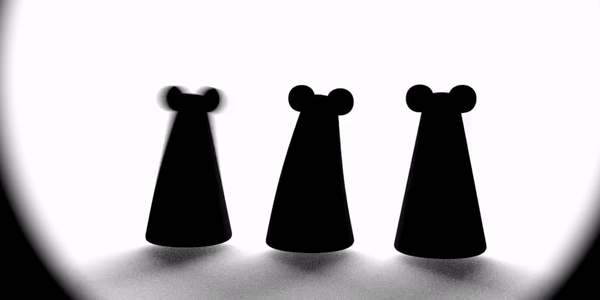

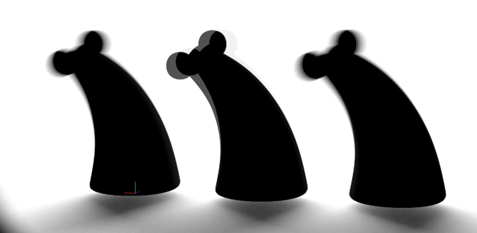

In the image below, the original 60 frames animation is in the middle with very visible steps.
On the right, the animation was stretched x5 to 300 frames and the individual steps are still very visible.
On the left it's the same animation stretched x32 to 1920 frames and provides a decent result.
