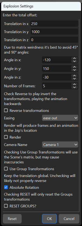

Running the script, you will receive a prompt to
- You can enter the translation off set,
- And the rotation offset
Both are total values that the Group with the highest number will have, while other parts will have fractions of the transformations depending on the amount of parts.
- The Number of Frames indicates how many steps are required for the explosion to finish.
You can use one frame to find the position you like and to create the camera animation. It's best to create keyframes for the camera on frame 1 and your desired end frame and then keyframe the starting and end position before running the script in the whole frame range.
- Reverse transformations will transform the explosion in reverse.
By default it will start with the entered transformations and go back to zero. - The Easing refers to the interpolation type, where you can chose between linear, ease in, ease out and ease in and out. Linear easing will have equal steps between frames.
Easing in will start slow and gradually accelerate, ease out will start fast and decelerate and ease in out is a mix of the last two where it starts and ends slowly and is fast in the middle. - The Render option will render each frame and compose a video in the directory of the .bip file.
- The Camera Name is for choosing which camera should be used for the rendering.
- Using Group Transformation is for using the actual transformations of the Groups, but due to Euler complications, it might not always produce accurate results, especially with angles >90°
- Absolute Rotation will keep the axis global, unchecking it will likely not properly assemble the Groups
- RESET GROUPS will reset all groups of the assembly back to zero.
