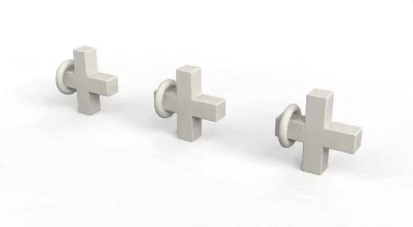

Below is the same geometry and animation with one little difference. The disk and the cross are in a group. That group has a rotation and before that, the disc is translated.
The left one uses the Original Local Axis Orientation, while the right one uses Global.

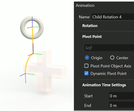

Dynamic Pivot
If you have a rotation that follows another rotation that uses a different Pivot Point, the pivot of the following animation might be offset.
In order to fix this

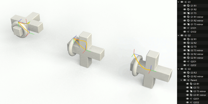

Mirroring Animations

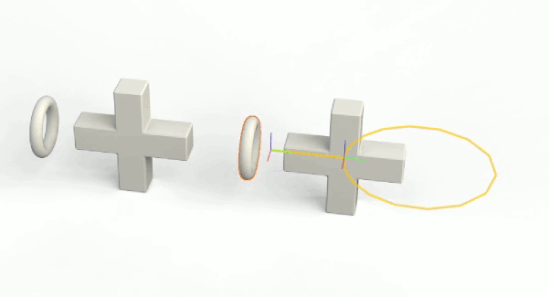

As of 2024.2, when mirroring an Animation Group, unfortunately, while the animation strips themselves are mirrored correctly in the timeline, the animation order in the Scene Tree is not reversed.
If the animation is a bit more complex and involves multiple rotations, it results in the ending position not matching the starting position, since by default, the automatic mirroring results in the wrong order (left object).
For example if the original animation is
  • Rotation1,
  • Rotation2,
  • Translation3
The default mirror result will be
  • Rotation1 mirror,
  • Rotation2 mirror,
  • Translation3 mirror

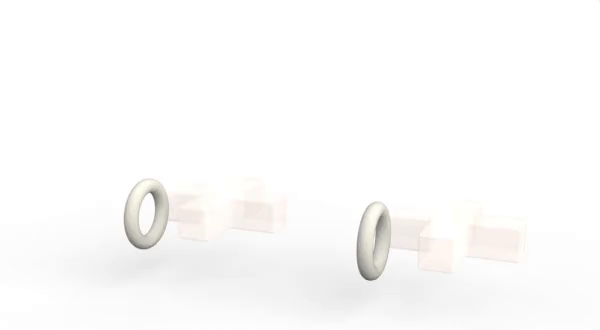

It should however not just be the reverse animation, but also the reverse order (middle object)
  • Translation3 mirror,
  • Rotation2 mirror,
  • Rotation1 mirror
However, that still results in a wrong animation. While the end position matches the starting position, the reverse animation deviates from the path of the forward animation as can be seen in the path displayed in yellow.

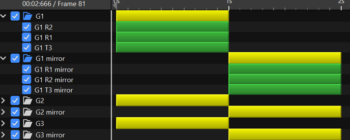

In order to fix this, the animation should be reordered as the following (right object)
  • Rotation1,
  • Rotation1 mirror
  • Rotation2,
  • Rotation2 mirror,
  • Translation3,
    Or a Sub-Group needs to be added in order to provide an additional level of hierarchy to transfer one rotation and its mirror to.

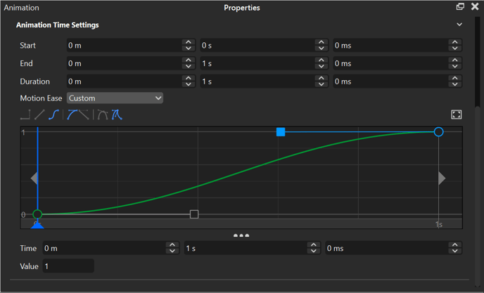

    Keyframe Motion Easing.
    This has been improved as of version 2024.2 and no longer relevant.
    For 2024.1 and prior, the easing is applied to the value rather than the time.
    This results that the value of an in-between keyframe will change to a value affected by the easing instead of the value that it was set to and altering it can prove difficult and unintuitive.
    For example:
    • Keyframe 1: 0s, x = 0
    • Keyframe 2: 1s, x = 500
    • Keyframe 3: 2s, x = 1000
    Selecting Ease Out as the Motion Ease for the example would then turn
    • Keyframe 2: 1s, x = 750
    and will not allow you to edit the number.
    It is therefore recommended to create the keyframe positions with the Motion Ease set to linear and only set it to something else when done and to switch back to linear for editing keyframes.
