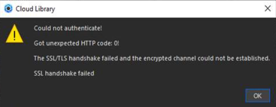

When attempting to access the Cloud Library through KeyShot, you may get the error message:
This message usually means that there is no connection to the site. This can be caused by various reasons. Try the solutions below to see if they resolve the issue.
