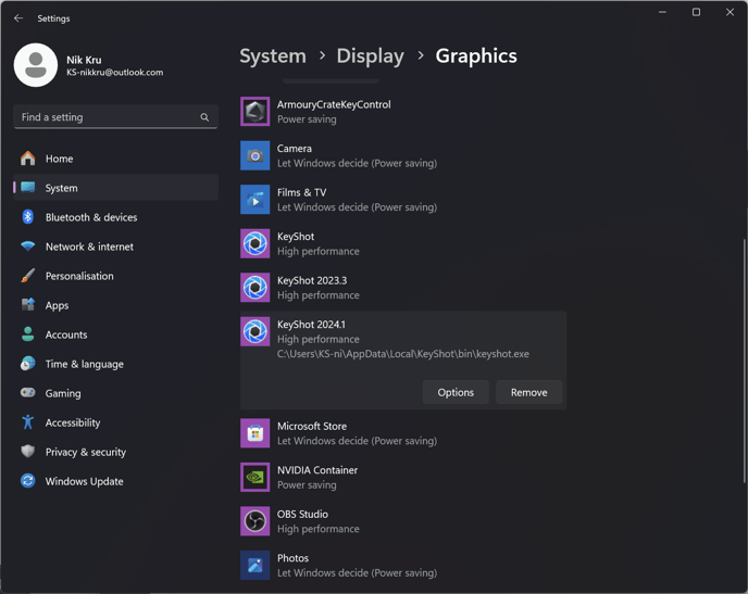

Set preferred GPU setting on Windows:
  1. Press the Windows + I shortcut to open the Settings app and click on Display.
  2. Under display settings, scroll down and click Graphics.
  3. Click on the Browse button and select the following depending on how KeyShot was installed
    Installed just for Me
    %localappdata%\KeyShot\bin\keyshot.exe
    Installed for everyone using this computer
    C:\Program Files\KeyShot\bin\keyshot.exe
    Please use the appropriate version. KeyShot 2023 would have a folder name KeyShot12\bin\keyshot.exe.
    KeyShot 2024 and every version after that will be just KeyShot

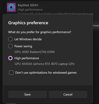

  4. Click on the Options button and select "High Performance" from the Graphics specifications drop-down menu.
  5. Click on the Save button to apply the changes.
  6. Restart KeyShot
