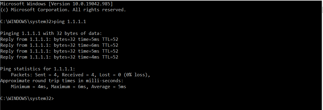

This can happen if the user's connection to the VPN network or the server host is not properly set up. To test this, while connected to the VPN network try 'PINGing' the Floating License server. You can do this by opening your terminal or command console and entering:
Please enter the required information and not the exact text written above. If you are able to contact the Floating License server you will get results similar to the picture below:
4 'packets' were sent, 4 were received and none were lost. Anything else will point to a problem either sending or receiving a reply from the License Server computer. If this is the case please contact your IT Administrator for assistance.
