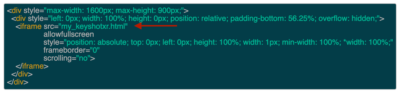

When you render your KeyShotXR the folder will also include instructions.html. Here you can find a section of code that almost can be copied directly into the WordPress editor on the page/post you want to embed it into. All you need to edit is the src URL so it points to the location on the webserver

  • Make sure the src URL location of the HTML file in the code matches the location of the upload.

The styling and div are around the iframe to ensure that the element works in a responsive layout. It will adapt to the width of the container, without losing the aspect ratio.

<div style="max-width: 1000px; max-height: 1000px">
  <div style="left: 0px; width: 100%; height: 0px; position: relative; padding-bottom: 100%; overflow: hidden;">
    <iframe style="position: absolute; top: 0px; left: 0px; height: 100%; width: 1px; min-width: 100%;" src="https://mywebserver.com/my_keyshotxr.html" frameborder="0" scrolling="no" allowfullscreen="allowfullscreen"></iframe>
  </div>
</div>
Replace following values
max-height/max-width: enter the size you rendered the KeyShotXR in
padding-bottom: the ratio between height and width in %. In this example it is 100% as the ratio is 1:1, a ratio of 16:9 would be 56.25%
src: enter the location of your KeyShotXR on the webserver.
