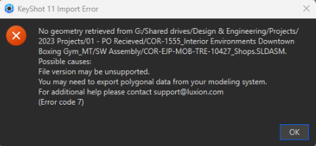

When importing a SolidWorks assembly into KeyShot, the following error occurs:
No geometry retrieved from {file path}/{assembly name}.SLDASM.
Possible causes:
File version may be unsupported.
You may need to export polygonal data from your modeling system.
For additional help please contact support@luxion.com
(Error code 7)
