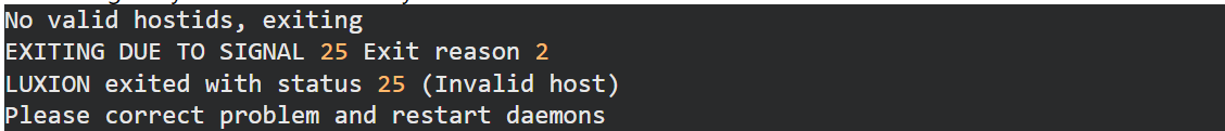

If you look at your Luxion.log file by clicking License Folder within the Luxion License Server and opening the Luxion.log file you will see the entry below.
This issue may occur if your internet connection changes from Ethernet to Wifi or vice versa. It could also happen if your Ethernet connection is enabled in one adapter and then changed to another adapter. When this happens, the HostID (MAC address) will change. To assist you in resolving this issue, please provide us with a copy of your KeyShot floating license and the information requested in the instructions below.
