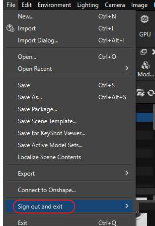

Solution 3
Clear cache in KeyShot Studio.
  1. In KeyShot, go to File > Sign out and exit. (This is important to disconnect any "remembered" users.)
  2. Delete the KS12Settings.xml file to clear any cached data.
    • If installed as "Just for Me", go to - C:\Users\<username>\AppData\Local\KeyShot12
    • If installed as "For Everyone", go - C:\Users\Public\Documents\KeyShot 12
  3. Restart KeyShot and re-test the issue.
