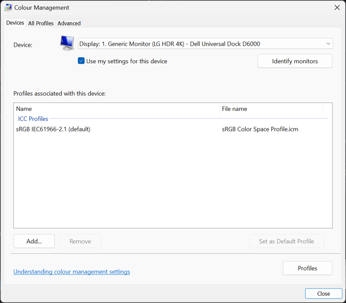

If restarting does not help, please open your Colour Management on your system. KeyShot will try to use the default profile. If it is corrupted or has restricted permissions KeyShot might not be able to generate the Color Lookup Table.
Go to Settings > System > Display > Color profile > Color management.
  • If the list is empty, please add a profile, a basic sRGB profile is a good starting point
  • If it already has an default profile, please try changing it to a different on or adding a new one and making it the new default.
Change your Windows Color Profile
