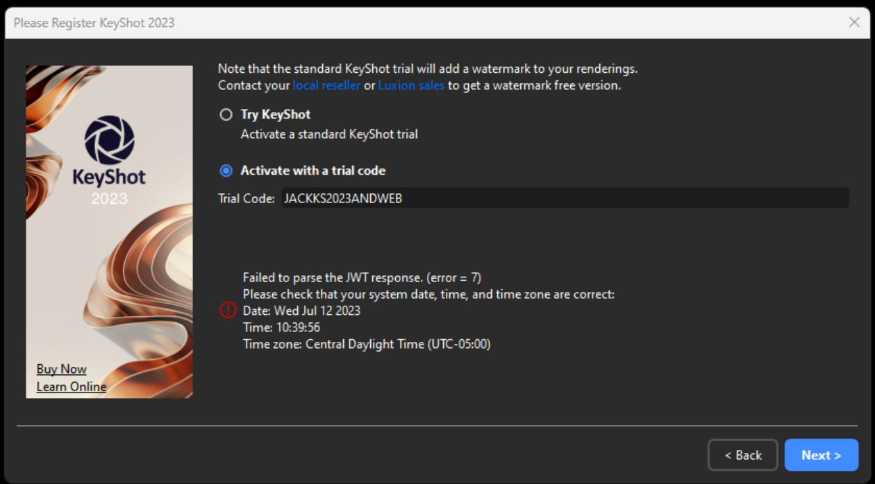

Error: "Failed to parse the JWT response. (error = 7)" when activating a KeyShot license
Getting the error "failed to parse the JWT response" when launching KeyShot.
Issue
After launching KeyShot and activating a KeyShot license, the following error below occurs:
Failed to parse the JWT response. (error = 7)Please check that your system date, time, and time zone are correct:

A subscription license has to be validated every 7 calendar days. The error can occur because of the following:
  • KeyShot is left on overnight
  • The logged-in user has not logged out correctly before restarting
  • The computer's system time and Timezone are out of sync or not set correctly
  • KeyShot can save the previous authentication token's date and time, causing it to expire
Solution 1
If you have not done so already, please restart your computer to clear the authentication token and confirm that your computer's date and time match the current time zone you are in.
