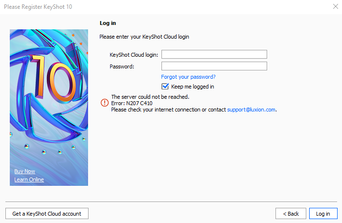

This article provides instructions on how to resolve the error N207 410 that occurs when activating KeyShot with a subscription license
Issue
When activating KeyShot with your subscription license and you get the error N207 410 it means you are using a client that is no longer supported by our Subscription server.
Environment Details
  • KeyShot
    • Any Version
  • Subscription License
Resolution
You would need to download the latest version of KeyShot from the link below and it should allow you to activate your subscription license like normal.
