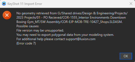

When trying to import a CAD file into KeyShot, you get the error below:
No geometry retrieved from... Possible causes: File version may be unsupported. You may need to export polygonal data from your modeling system.
