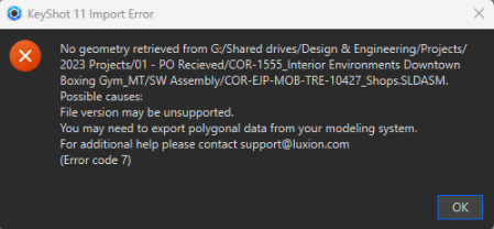

When trying to import a CAD file, usually step files or SolidWorks-related files, the user will get the below error, even though they were previously able to import these files.
No geometry retrieved from... Possible causes: File version may be unsupported. You may need to export polygonal data from your modeling system.

  • The upgrade to Sonoma 14.4.1 appears to have caused a bug that caused the import to throw this error.
  • Error code 7 occurs when using an unsupported CAD version with KeyShot.
