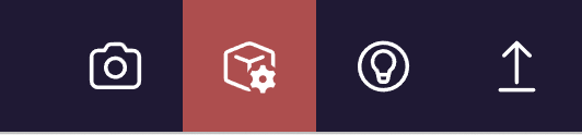

  3. Go to the bottom right of the page and select the 'Inspector" icon

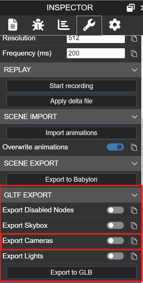

  4. In the Inspector panel, select the 'Tools' tab (the wrench icon)
  5. Scroll down to the GLB export section
  6. You will be able to toggle on and off 'Export Cameras'. Be sure to toggle it off
  7. Click 'Export to GLB'
  8. Save the file
