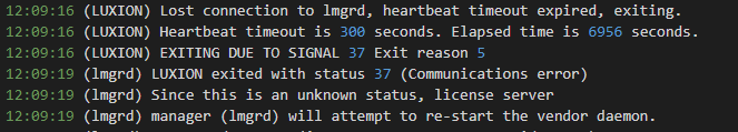

If you look at your Luxion.log file by clicking the License Folder button within the Luxion License Server application and open the Luxion.log file you will see the entry below.
