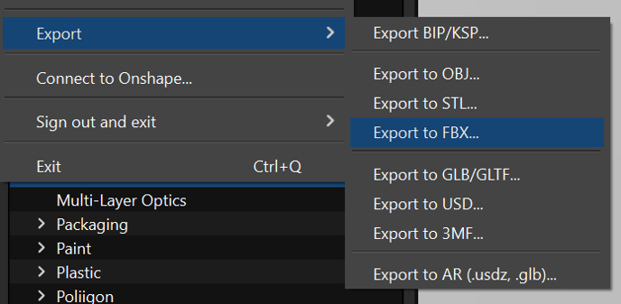

  1. Export the Scene as an FBX. If you only need a few objects, you can select the ones you want to export and enter Solo Mode (hotkey S) before exporting.

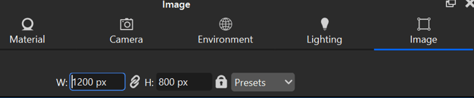

    Please also take a note of your resolution and aspect ratio in the Image Tab.

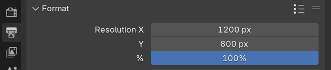

  3. Importing it in Blender, please adjust the resolution and aspect ratio in Blender's Output tab.
    After that, you may notice, that the camera still doesn't exactly match and that there is clipping.

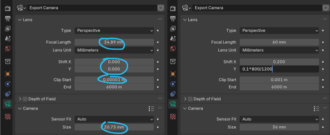

    In the camera's Data settings please adjust the following:
    • Set the Camera Sensor Size on the bottom of the settings to 36mm
    • While it's only a visual aspect, you can increase the Clipping Start in order to fix the clipping
    • Set the Focal Length to match the Focal Length setting in KeyShot
    • If you have a Shift Camera, adjust Blender's Shift X to be the value of KeyShot's Horizontal Shift with the reverse sign. (e.g. -0.2 in KeyShot should be 0.2 in Blender)
    • If you have a Shift Camera, adjust Blender's Shift Y.
      Currently in KeyShot, the vertical shift is dependant on the resolution, so the resulting shift is the entered value multiplied by the height and divided by the width. (KEYS-33800)
      In this case, it would be 0.1 x 800 / 1200 = 0.6666666
      You can do the math directly in Blender's edit-box as shot below.
