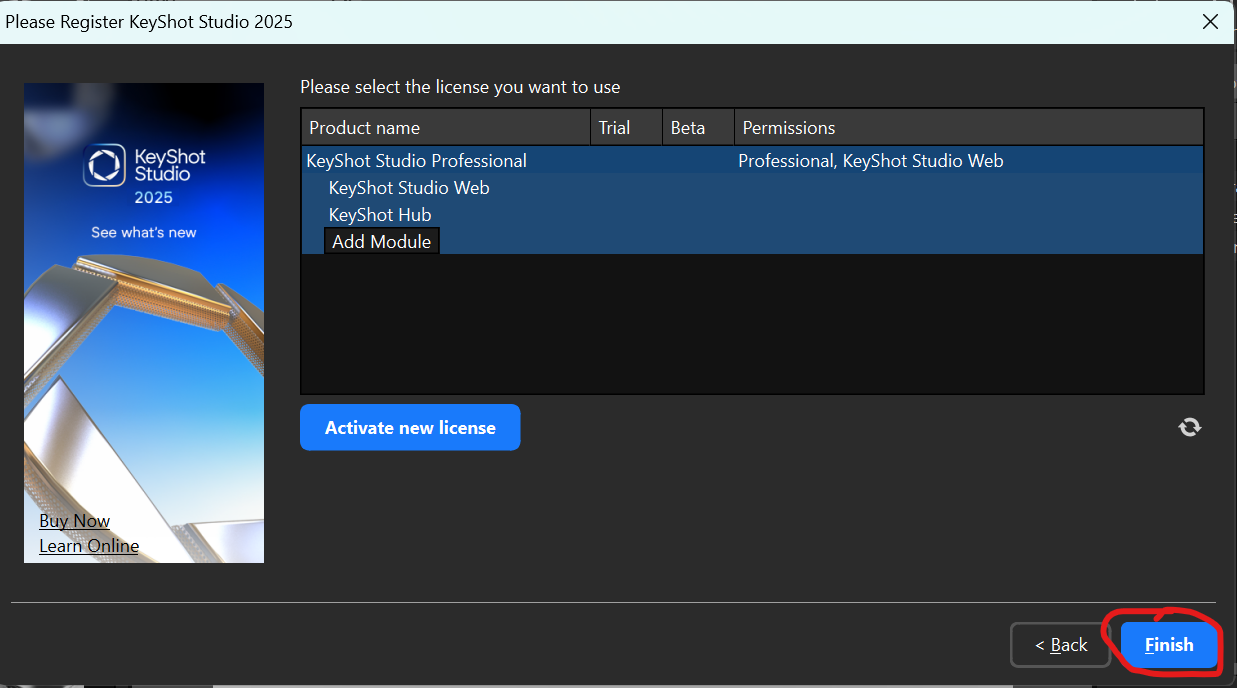

If the license has already been activated, you do not need to activate it again with a serial code. Instead, you only need to log into your KeyShot Cloud account and select the correct license.
See the instructions below:
1. Select 'Activate my license'.
2. Select 'I have a subscription'.
3. Sign in to your KeyShot Cloud account.
4. You should see a screen like this:
5. At this point, simply select ' Next' and then 'Finish' ( Do not select 'Activate new license').
