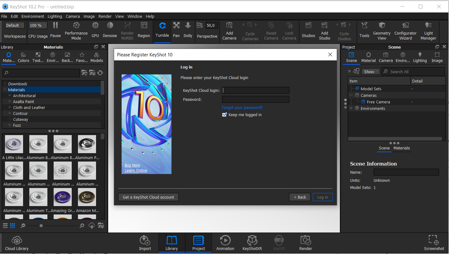

1. Either when first launching KeyShot or activating your license through the 'Help' option, you will be given the options:
  • Activate my License
  • Get a Trial
2. Selecting 'Activate my License' will allow you to activate your license using a serial code, an existing license file, connect to a Floating License server, or through your subscription.
3. Select 'I have a subscription'.
4. This will give you access to KeyShot no matter where you are, without having to deactivate/re-activate your license.
