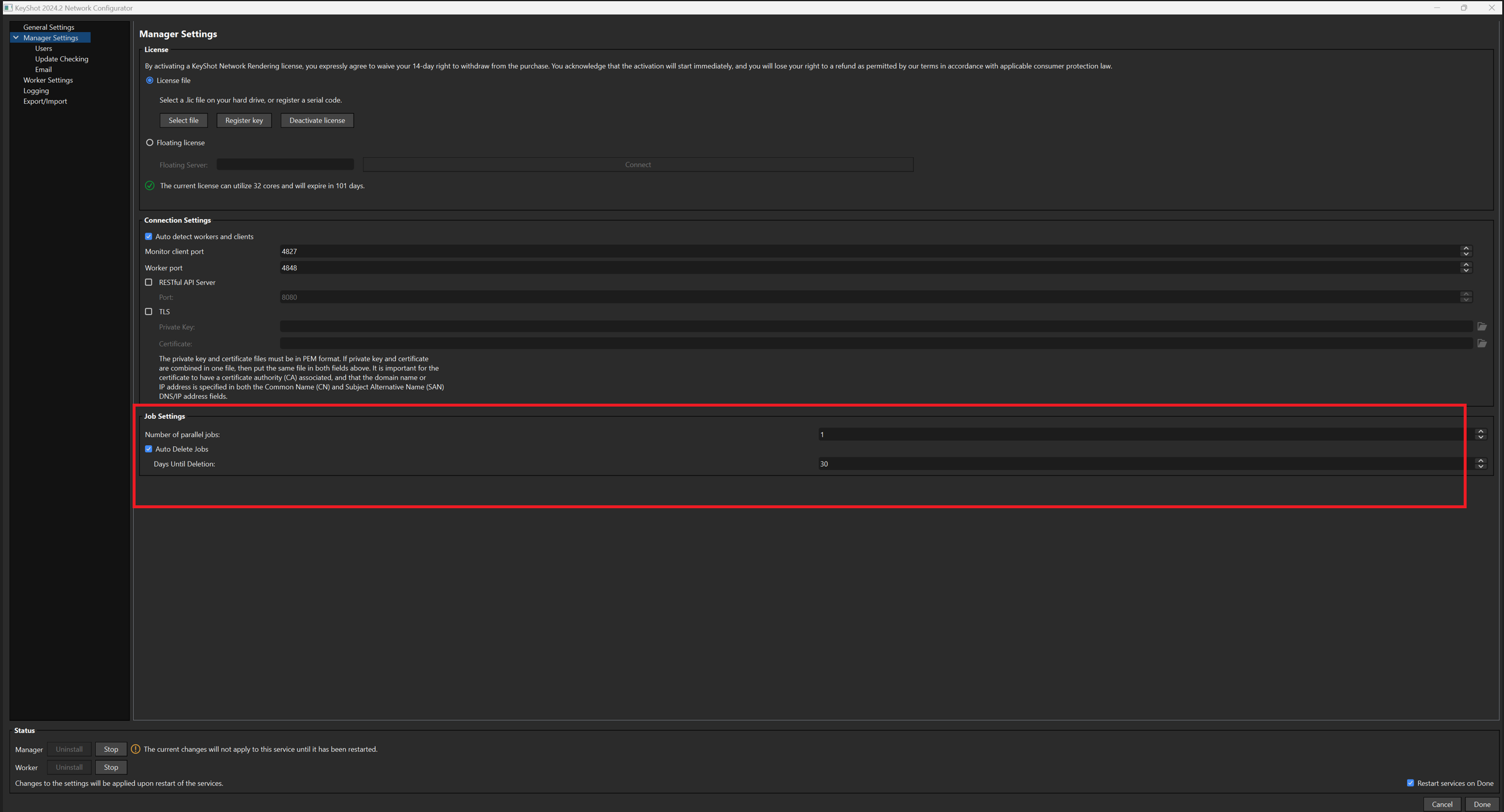

  1. Open the KeyShot Network Configurator application on the machine acting as the Manager.
  2. Navigate to the Manager Settings tab.
  3. Scroll to the bottom of the settings page to find the Job Settings section.
  4. Select or deselect the option to automatically delete jobs after a specific number of days.
