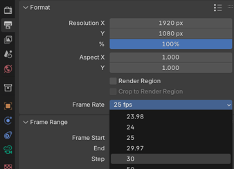

In Blender's Output settings, please make sure that the framerate matches that of KeyShot

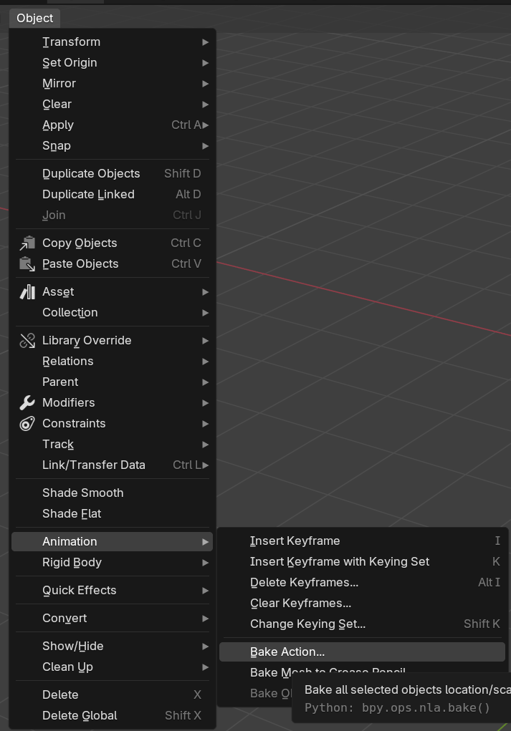

Then bake the action, by going to Object → Animation → Bake Action

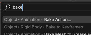

or by using the Search bar.

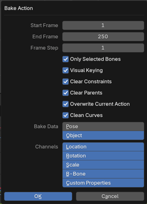

Then bake the action clearing parenting and constraints
and export it as an FBX. Make sure to limit the  export only

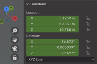

You can manually adjust the camera based on the angles in Blender by navigating to the first frame and adjusting the angles in KeyShot. Please not that KeyShot uses y-up axis, while Blender uses z-up so you will need to convert it accordingly.
E.g. here: x = 36,872° → Azimuth = -90° - 36,872° = -126,872°
z = 29,497° → Inclination = 90° - 29,497° = 60,503°

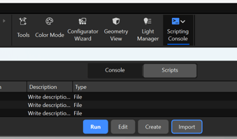

In order to add the script to KeyShot, you can unzip the script and import the .py file through the scripting console or by copying it into the Scripts folder in your Resource Folder

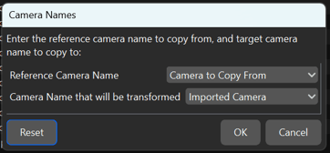

When you run the script please make sure that the camera you want to copy from is set as the Reference Camera and the your imported camera as the one that will be transformed.
Please use the existing camera in KeyShot or export the unanimated camera on its first frame from Blender to use as the reference camera to copy the transformations from.
