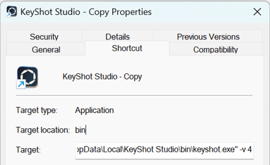

  • You can also edit the shortcut or a copy of the shortcut and add  -v 4 to the end of the Target.
