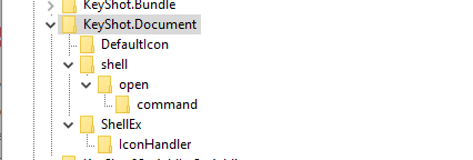

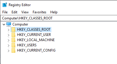

Click your Windows search bar and type RegEdit. 1. Select HKEY_CLASSES_ROOT 2. Go to Computer\HKEY_CLASSES_ROOT\KeyShot.Document, and make sure entry looks like image below. 3. If any of the entries above are missing make sure to right-click and add new Key in the KeyShot.Document folder. a. DefaultIcon     b. shell\open\command\ c. ShellEx\IconHandler The information should match that in those locations.
