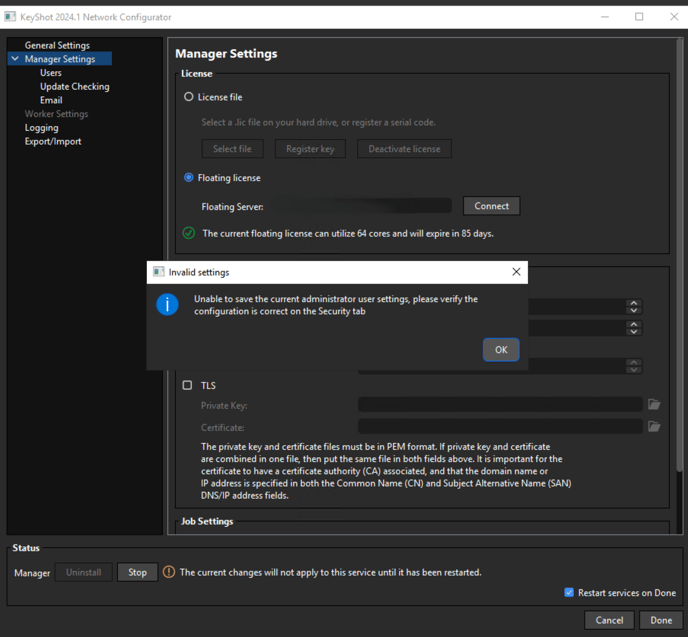

While configuring your Network Rendering Configurator, you may receive an error message stating "Invalid settings," as shown below.

If you encounter this error message, it typically indicates a discrepancy within the User settings. Follow these steps to resolve the issue:
Navigate to Manager Settings within the Network Rendering Configurator. Under the Users tab, determine whether you want to enable the User System. If you choose to enable it, input a username and password for the administrator. If you do not need or want to enable the user system, simply uncheck the 'Enable User System' option.
Updating these settings should resolve the "Invalid settings" error message.
