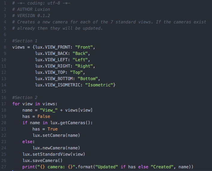

Create Standard Views creates seven standard view cameras: front, back, top, bottom, left, right, and isometric. At the end of the article, you will find the annotated script code for your reference.
How the script works:
Section 1: Create dictionary variable views and assign a name for each of the seven standard views.You can find more information about the KeyShot standard views here.
Section 2: Create seven cameras with the names defined in Section 1, and then set the right camera angle.
  • Create a loop that goes through each view name defined in the view variable.
  • Assign the view name to the name variable.
  • Create a boolean variable has and set it to "False".
  • Check if one of the pre-existing cameras already has that name. If it does, set the has variable to "True" and set it's camera to be used for that viewlux.setCamera.
  • If the camera name does not exist already create a new camera with the right name using lux.newCamera.
  • Set the right angle for that view using lux.setStandartView.
  • Save the camera.
  • Display a status message in the console.

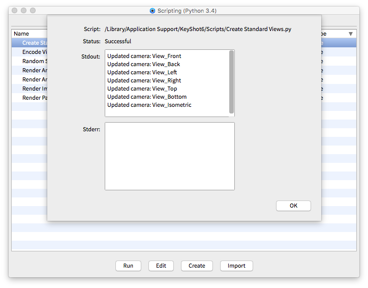

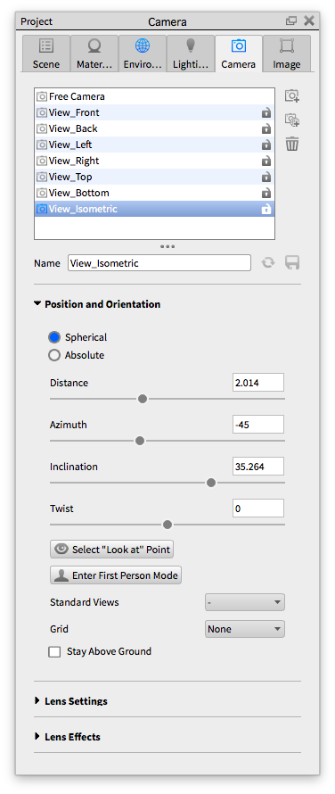

After running the script, you will see your seven standard views saved as cameras in the Project window > Camera tab.
