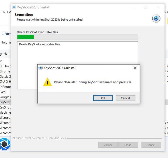

Issue
When attempting to uninstall KeyShot Studio, you may encounter an error message indicating that there are multiple instances of KeyShot running.
Environment Details
  • Product: KeyShot Studio
  • Version: Any
  • Operating Systems: Windows or macOS
Cause
This issue occurs when one or more KeyShot processes are still running in the background. This could include:
  • Open KeyShot application windows.
  • KeyShot Studio processes running in the background.
Resolution
  1. Close All KeyShot Processes:
    • Check if any KeyShot application windows are open and close them.
    • Open the Task Manager (Ctrl + Shift + Esc on Windows) or Activity Monitor (on macOS). Look for any processes named "KeyShot" or "KeyShot Network Rendering" and end those tasks if they are running.
  2. Retry Uninstallation:
    • Once all processes are closed, return to the uninstallation prompt and click OK to proceed.
  3. Restart Your Computer (if needed):
    • If the issue persists, restart your computer to ensure no KeyShot-related background processes are running. Then attempt the uninstallation process again.
